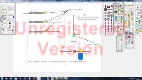

Here's a real quick drawing that shows the basic principle and components.
[Hearth.com] How Does The Constant Flow Thing Work?
How does that work to maintain a zone's temperature?
Thinking more about it, it won't if you have a constant water temperature. You need a controller to tell the pump to speed up or slow down in response to room temp, rather than water temp differential. I'm not sure if anyone makes something like that or not, and as Heaterman pointed out it wouldn't be ideal for a long serial run of baseboard because you would have extreme water temperatures.
