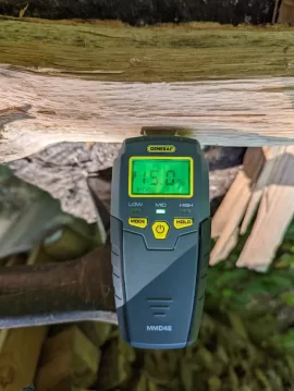

Is that on the end grain or a fresh split? It needs to be on a fresh split with the prongs on the same line, not across the grain, or you'll get false low readings. You'll know immediately upon burning it if it's dry or not
Here's what it should look like when you're measuring. This is red oak that was CSS 2 years ago:

FWIW, those General meters (at least mine) reads consistently low by about 4%. The orange one on the right matches what someone else's meter shows and theirs matches what an EPA testing agency uses. I have stopped using the General and only use the four pronged orange one.

One would think the red oak I posted in the photo (C/S/S in spring '15) would be closer to 14% than 18%....but that's not what the other guys meter said. As his matched what my orange one said.

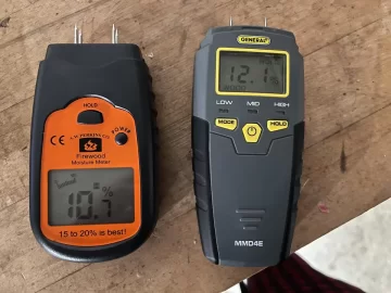

I don’t have three hands to take a picture and hold both meters. I tested a piece of ash that’s been sitting in my basement and hit the hold button once the numbers were no longer moving. Checked it roughly in the same spot with both meters.
The meter of the left came with my Heatmaster OWB.
[Hearth.com] How dry is dry enough?
;lol Well, this sure doesn't prove anything! Completely opposite of what I showed.
Just stick the meters in far enough so they stay! :p
They sure did give you a pricey meter with your HM!!
