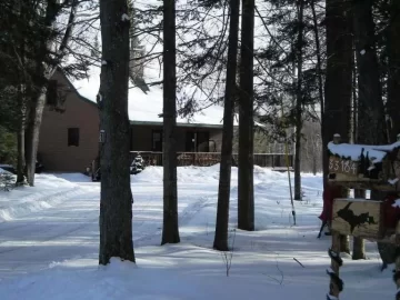

Thanks for the welcome. Don't want to harm this cabin any:

That is a mighty fine looking cabin there Yooper. It should provide you with much comfort, especially now that you have wood heat.

Nice "cabin", but I see you don't have as much snow as I would have expected.

Yes the snow level is down this year. Apparently the El Nino has kept a lot of systems south of us, hence the east coast getting more moisture.
