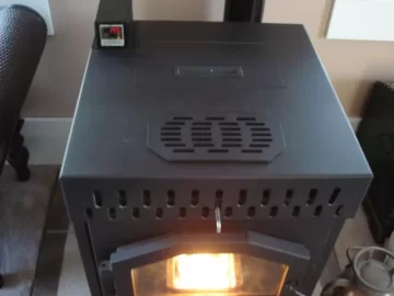

Years ago, when I burned wood, I had a pyrometer on my stove pipe. It helped me keep the temp above 212 degrees to limit the formation of creosote. I guess it's my engineering background. My motto has always been "the more information, the better". (That's why I alsways hated cars with idiot lights, but that's for another forum) I initially used a meat thermometer stuck in a heat exchanger tube, but it just gave me general information. I needed more. I put the word out to the electrical department at work, that I was looking for an old temperature controller. A few weeks later, I got a little Omron 4 to 20 ma controller. I fabricated a little box out of 20 gauge mild steel, painted it flat black, and ran the type J thermocouple under the sheet metal of the stove and into a heat exchanger tube to make everything look like it belonged there. I would love to get a probe into the stove pipe to get a reading there but I have to think about that one for a bit.
Here's a couple of pictures I took this morning.
Chandler

Sweet! I thought I was a techie. I love seeing others Ideas at work. That is on nice neat set up. Looks like it belongs on the stove too!
Edit: Easiest way in the vent is through the Tee cap(only one wall to pass, I'd say. How to get the wire run neatly may be a little challanging though. I am going to get a SS bung and weld it to the cap.
jay
Thanks Jay! I wanted to build it into a side door but, believe it or not, there isn't enough room. This was my next best idea.
Chandler
