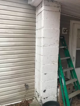

Going to cut and install a clean out door for this masonry chimney. How high off the ground should I cut it in?

I like to be at least 3 feet off the ground so you canclean from the bottom easily. Or 18 to 24 down from the crock.
Make sure the door seals airtight. Leakage can spoil draft and increase creosote accumulation by cooling the flue gases. You can make a gasket for the door by applying a thick bead of silicone and closing the cleanout door on it.

A good quality regular silicone is fine. It will not get hot there.
I don't have a very high roof, so cleaning from the top is easy easy. should I still go that high?i was thinking like 8 inchs or so
I'd go at least 18" to be above splashing and most snow. 24" would center it on the 3d block.

Is there a stainless liner in the chimney or clay tile? If clay tile then yes, make a simple gasket for the door using silicone unless the door is already gasketed.

You clean it out through the cleanout. Why else would you be putting one in?

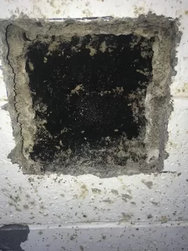

Welp, busted the hole out for the clean out. Doesn't look like the liner goes down that far :(
Guess my only option now is stainless steel liner?

You really need a new liner.
Why would they only put liner in from the crock up? and 5 feet short of the top at that. lol
Looks like to metal bars going through the chimney holding the bottom piece where the crock goes in
Because they had no clue what they were doing or didn't care.
