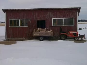

Welp - just to point out some obvious stuff that has already been touched on...
The reason it is hotter inside than ambient temp is because of stagnation of air. Stagnate air isn't very good at drying wood. To compensate - you move air. The more air you move...the closer the interior is gonna be to ambient temp. Its kind of a catch 22.
My opinion is that closed storage should be for wood that is already dry (or darn close to it). If it ain't dry or you don't have 3 years to let it sit, leave it outside where it belongs. I have a south facing fairly large old chicken coop that I played around with years ago to test all the "kiln" stuff with. Mixed results. It works best as dry storage. Just one dudes opinion.

I think the solar kiln as wood drier is a proven thing. The question isn't whether that works or not. The question is whether a garden shed will make a good solar kiln. Your experience with an old chicken coop suggests a non-purpose built closed structure might not work well. Maybe the OPs shed will work better, maybe it won't.
