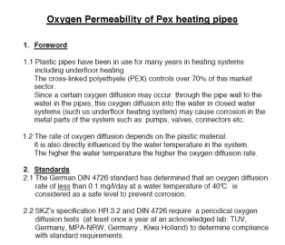

Here is some info on the standard and amount of O2 they test to.

That's all been done and if one does a little searching on the www the specs for oxygen diffusion are readily available. The specs are mainly from Europe under DIN standards. The jury of scientific method is in and has spoken on this many moons ago. Non barrier tube is not suitable for heating use if you want long and trouble free life from your heating system. One can definitely argue the total surface area of the tube in the system being a mitigating factor but it happens to some degree in any case. Personally I have seen two infloor systems so plugged up they could not be cleaned and had to be abandoned.
