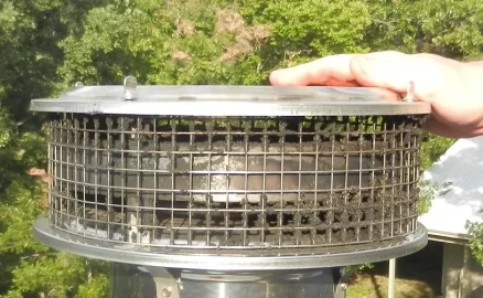

The cap has a bit of flaky creosote. I brushed it off with my hand.

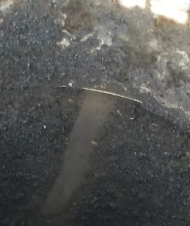

This is inside the flue, just below the cap (the bottom of the cap can be seen as the bright horizontal edge where my finger brushed it).
[Hearth.com] How long between chimney sweeps?
The smooth area is where I ran my finger up the pipe - what you see is the stainless interior underneath a vanishingly thin coat of creosote - less than 1/32". And this extends down only six inches. Below that it is just dust. The creosote could be wiped out with a single paper towel.
So how long between sweeps? How about never? This flue has been in use for eight seasons and has never been swept.
That should have been swept a while ago. It looks like that could possibly be some burnt material in the top of the second pic. But it is hard to tell. I clean every 2 years. What does your chimney look like lower?

Really 8 years. My cap like yours didn't make it through the first year and it was plugged The wood then was a bit wet. That chimney doesn't look very good. So I assume you brushed it. How much did you get out of it? If not your playing with fire. Have you every seen a chimney fire? There must be one on You Tube.

If I went for 8 seasons without cleaning, I'd like to think mine would be like that (it's dense, but still stage 1 creosote, no?)
Sorry, got busy doing other things.
Yes, clean it when it gets dirty. My close up photo probably made it look worse than it was. I actually wiped out the entire area with a single paper towel. It did not fill the towel with particles, it merely turned the towel black. There was nothing to sweep. The cap, on the other hand, had probably 1/8 cup of creosote on the screen that I brushed off.

This all being said for 8 years that build up isn't terrible. It definitely needs a sweep and I wouldn't want to run like that before doing so. I'd also be worried if that were only a year but based on your accumulation for an 8 year cycle, a yearly sweep is likely all you're going to need. Again, adjust based on findings from the previous sweep.
