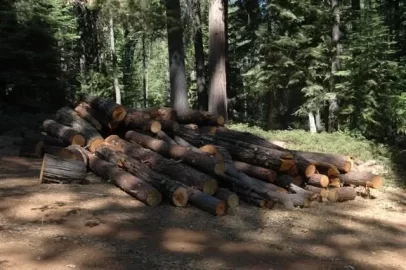

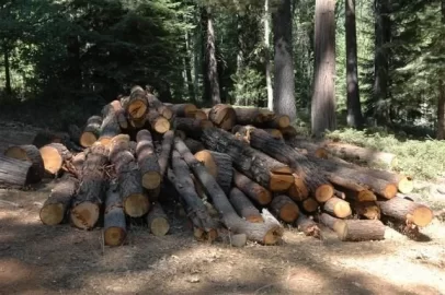

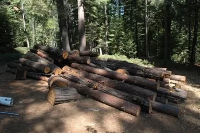

I'm new to the forum (and woodburning), and have a newbie question.
I just purchased a PE Spectrum, with a maximum log length of 18". This weekend, I'd like to get started cutting the pile in the attached photo into rounds, so I can split next weekend. I'm wondering if you folks would be so kind as to give me some advice on the length I should cut the rounds. Should they all be max length (18"), or should I mix it up a bit (some 12", some 8").
The logs are cedar and pine.
The stove is in my studio/office, and I'll be burning it 9-5.
Thanks for your help.
Bob
P.S. For those that like to play the "guess how much wood in the pile game", I'd appreciate your estimate on how much split wood I'll get from the pile....

Hi Bob and welcome to the forum. I usually cut my wood about 2" less than the max length. With an 18" max, I would say 16" is a good length. You want to leave a bit of room for air flow beyond the ends of the splits.
I usually cut everything to approximately the same length, except for those odd sized end pieces. What I then do is split some smaller and leave some larger and some in rounds. That way, I can pack the firebox well and it's nice to have some small splits on hand for starting or re-lightinig a fire.
Exactly what Griz said. There are always going to be the wierd pieces...those go in the stove early in the season.
Id go 16 too, its nice to have a little room to work with. Id guess 2- 21/2 cords from what I can see in the pics. Do you plan to burn this wood this year? If so youd better get it split ASAP and even so it may still be a bit green.
16"
2.5 cords
Get it split and out of the shade!
At second look maybe 3 cords Pics arnt that clear on my PC ( a POS ) Where are you? the terrain looks very close to here same trees and all.
Thought it looked like home. Im on 88 just above 4000' so just above you. Would dries pretty fast here especially cedar and pine and with the weather weve been having. But still I wouldnt waste any time. get it cut split and in the sun! If it doesnt look like it will be ready and you want to make the trip I have excess cedar and pine and we could trade out a load of green for dry. Nice to hear from a local!
Thanks for the offer, nshif, I might just take you up on that offer. I have about 3/4 of a chord that's dry to start out with, but then will need to use the new stuff. Might not be dry by then, so I'll stay in touch.
(On the topic of "it's a small world", I responed to a post on hearth.com last week, and it turns out the original poster just bought a cabin right next door to a lot that I own around the corner from my house. I hadn't met her in person yet....)
Ive found its a very small world up here. have run into quite a few folks I knew down in the bay area years ago. If youd like to swap some out just dont wait to far into winter because this pile is " down the hill in the back 40 " and not to accessable in the winter.
