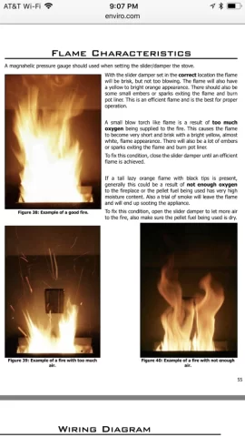

Short cut for Johneh’s link i use the same picture lol
Thank you Johneh and Ssyko - I printed this for reference. This is a huge help, as previous technicians adjusted the flame to be like the one that this page says has too much air!
