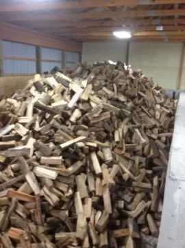

This should help with creosote , and the single digit temps coming my way .
Picked Up a half a cord of good dry wood, Mixed-Oak, Hickory, Cherry, Black Locust, Maple, Ash, paid $75 , stored inside.
Hay what does Black Locust,look like ???

if there's bark on it... black locust has this insanely deep grooved bark that kinda/sorta has the pattern of expanded metal... the wood itself is fairly dark color with an insanely twisted grain...
in your picture, in the bottom third, towards the center there are two pieces of wood that are darker... to my eye, those look like locust.
Some of the splits I looked at , that I didn't know what it was, were brown to reddish brown in color with big pores in the wood ,I'll put up pics later
