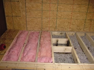

I framed mine in with 2 x 6 construction, R19 fiberglass, and backfilled the whole tank with cellulose fill. This was three years ago and the cellulose has not absorbed any moisture, dry as a bone. I did some heat loss trials at 130 deg F, lost only 2 degrees per day with no flow.
  • [Hearth.com] HOW MUCH TANK INSULATION?
