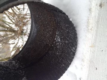

3 weeks and I have this.... Good or bad
  • [Hearth.com] How often
Pretty normal, not great, but not bad either. What is more important is the accumulation up top where the flue gases have cooled down a lot.
