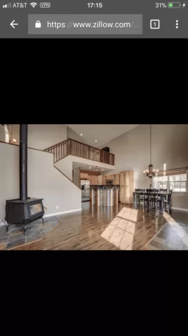

How small of a house for a King
We agreed to buy this house. I will be inspecting the house on Saturday. Is this a king or a princess? I thought it was 8” pipe when I took a quick look at it but I could of been mistaken.
Anything in particular that I need to look for with the model of blaze king?
Well, cloning the stovepipe onto the tile makes it look like a 6" flue.
I think I remember reading somewhere that very old pre-EPA Kings had a 6" flue? Not sure about that.
Get the model number off the back!

I would question that because I don't see a cat bypass handle. Maybe it's hidden on the other side?

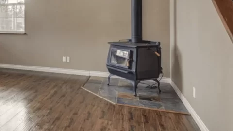

Yes. Cat handle is on the other side. It’s single wall pipe up 25’ to a support box. And from there I am not sure since I have not been in the attic. I’m very comfortable assessing the install but the stove itself I don’t have much experience with. I’m leaning towards it being a princess.
Here’s a view from the other side
Dunno. I don't think it looks like a current princess or king. I will have to defer to the experts on this one.
Here's a princess on legs from BK's website.
Thanks. Other then the color of legs it looks very close to me. But pictures are deceiving.
Yeah, the apparent ratio of width to height is not the same, but it could be in the photos like you said. Check the tag!

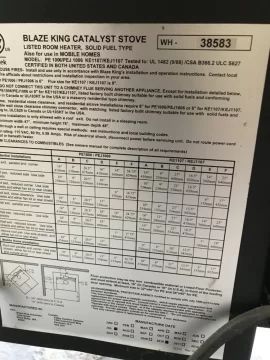

We inspected the house today. While there I took a look at the stove. It seemed to function properly. The cat was very white and looked kind of brittle. Is this normal on these stoves?
Sticker says it's a Princess. It still doesn't look like a princess or a king to me in that first photo! They ship with ceramic cats, so yes white and yes brittle. The cat shouldn't have been visible unless you removed the plate that sits in front of it.
Honestly after 7 years of unknown things being burned in there, be pleasantly surprised if the cat works, but be prepared to replace it also.

It was built towards the end of 2010 I think it said on the sticker. Not sure when the design changed.
When I looked up inside the stove I could see a white brittle looking honey comb like structure. There was a plate covering it but each side had fairly big holes that I could see thru. I should of taking a picture but it looked factory designed. Didn’t look like someone modified anything.
Yeah, that's right. That plate can just be lifted off of there- it's a flame shield to keep direct flame off of the cat face.
