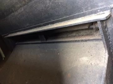

We have a cabin with a stone fireplace that I want to install an insert in. I'm looking for an inexpensive but safe and correct way to do it.
I found a really nice old used Bollard insert at a great price, but the flue has me perplexed. It opens off the rear of the insert, facing back, and is 3"x27" long.
[Hearth.com] How to adapt tricky insert flue to liner
It's not a great picture, but hopefully you get the idea.
I don't see anywhere to attach a flue, and don't know if it could be adapted to say an 8" round, and turn a 90 angle to go up.
I like this insert, the price is right, and I want to make it work. Any suggestions?
Thanks,
David

That is a 30+ year old insert, it is just a steel box that you burn wood in, nothing really "nice" about it. The problem is you are looking during PEAK season, you should have been looking in the spring-summer time if you wanted a deal, now all that is left is the overpriced junk everyone had stored in their barn till now.
Keep looking, there are still deals to be had (just more rare) from people buying a house and not wanting a wood stove.

The squire on the bottom has a rectangle exhaust so you are back to finding a boot for it, both the timberline and the squire will require 8" liners, can you fit that down your chimney?
The 13I will require a 6" liner and is $899 from AMFM: (broken link removed to http://www.amfmenergy.com/collections/timber-ridge-brand-new-factory-seconds-or-manufacturer-refurbished-stoves/products/50tnc13i-epa-certified-noncatalytic-wood-stove-1550131501)
Make sure whatever you get will fit and the clearance to combustibles is met.
