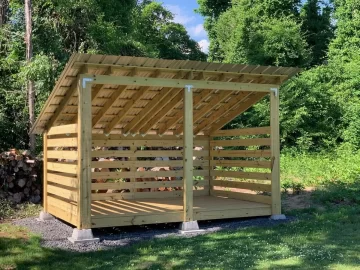

Hi All,
I built this shed this past summer and Im struggling with how to best stack wood in it. Currently I have been stacking it in rows left to right however Im finding this method not the most useful for my scenario. It holds around 4 cords but I typically burn about 2-3 per season. This leaves some wood still in the shed at the end of the season so if i go to add new wood that is less seasoned I have to empty out the shed and put the greener stuff in the back. This is my pain point so looking for alternate methods to stack. I was thinking of stacking front to back instead of left to right and then make some lincoln log stacks on the end so the wood doesn't roll out the front. The other option I was thinking of was sectioning out the shed by running some 8' planks from the front center to back center so I have a left compartment and a right compartment essentially making it into two 4' x 6' sections instead of one 8' x 12' and then stack the wood left to right. This way i have a greener side and then a more seasoned side. Are there any other options you could recommend? Out of my two options do you think one is better than the other? Thanks

Is this shed for wood that you are storing wood that is already seasoned? The reason I ask with 8 ft deep and let’s say your splits are 16” long. Front to back that 6 rows deep to make 8’. Don’t have a wood shed but how would that season well? Just asking since I would think the inner rows would not get sun or much air circulation.
Really nice shed by the way!

How do you get your wood? If you get it all at once you could get by with a dry side and a not ready yet. But if scrounge like me, I would stack left to right make 3 bays. Ready to burn today, next years wood, and really really wet.
Left to right will be the easiest to pack it full and most stable.

Remove the slats across the back and move the stacks behind it so you can get to the back of the shed with whatever you use to load and unload wood. Then you can unload dry wood from the back and fill it up with wet wood, then unload from the front next year. I.e. a first in, first out queue rather than the first in last out that is is now. I'm planning a shed that looks a lot like that and I would make it accessible from both sides if I had the room. Level ground is scarce here.
Splitting it into bays would help too.
^ This. I would do this.
At first glance at your shed (which is very nice) I thought it was missing the center divider which not only helps segregate the wood for different years but also makes it easier when loading /unloading so the wood piles don’t fall everywhere. Given your burning pattern dividing it into two is simple enough to do.

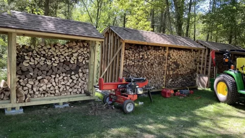

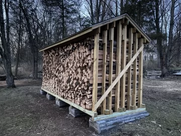

This isn't the easy answer you'd like to hear, but personally, I'd tear the roof off and rebuild it for access from both sides. My sheds are broken into four 1-cord bays, for this very reason. Each bay is 8' wide x 36" deep, and holds two rows of 18" splits. Two bays on one side, two on the other, for easy drive-up arm's length access to all wood, without walking into a deep shed. I have four like this, and a fifth that's smaller.
View attachment 311496 View attachment 311498
Really like these. 2 rows deep is perfect allows for fast seasoning!

With all the tractors, I’m surprised you haven’t gone modular and insert 4x4 sections of palletized firewood.
Me? Thought about it, but there were several disadvantages to it, which pushed me toward the method photo'd above:
1. My wagon fits onto the patio under my covered porch real nice, but my tractor does not. So, I'd have trouble easily getting these pallets onto the patio far enough to be fully shielded from blowing rain and snow.
2. I must traverse a side slope hill while moving wood from processing area to the house, which would limit the size pallet I can carry with my tractor (present heaviest is Deere 3033R with loaded tires).
3. I like to shake the mouse nests, bee nests, and spiders out of the stacked wood before bringing it up to the house. Moving it from shed to wagon is a good way to do this.
4. Palletized is harder to roof, and takes up much more ground space for the same cordage. My processing area is limited, pinched between an old rubble stone wall and my property line.
