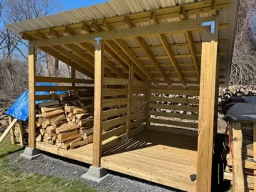

Hi All,
I built this shed this past summer and Im struggling with how to best stack wood in it. Currently I have been stacking it in rows left to right however Im finding this method not the most useful for my scenario. It holds around 4 cords but I typically burn about 2-3 per season. This leaves some wood still in the shed at the end of the season so if i go to add new wood that is less seasoned I have to empty out the shed and put the greener stuff in the back. This is my pain point so looking for alternate methods to stack. I was thinking of stacking front to back instead of left to right and then make some lincoln log stacks on the end so the wood doesn't roll out the front. The other option I was thinking of was sectioning out the shed by running some 8' planks from the front center to back center so I have a left compartment and a right compartment essentially making it into two 4' x 6' sections instead of one 8' x 12' and then stack the wood left to right. This way i have a greener side and then a more seasoned side. Are there any other options you could recommend? Out of my two options do you think one is better than the other? Thanks

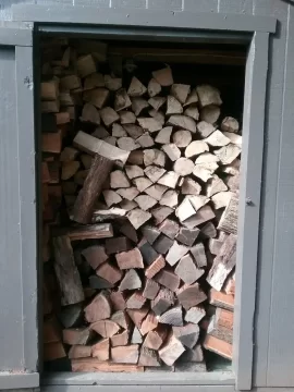

Like this , with good air flow which you have.

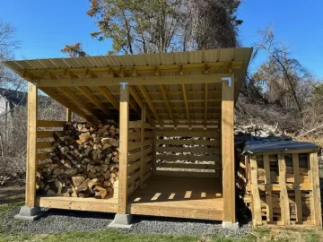

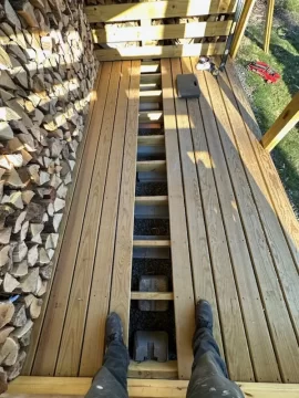

Thanks for all the input everyone! I added in a divider this weekend to make it 2 compartments, I'll see how this works out for me and if needed it will take me a few minutes to remove the slats in the rear (also a great suggestion i wasn't even thinking about). While I was at it I also removed two boards in the center and added more bracing under the joists, I realized I didnt have enough support and was getting some sag in the center this past winter when it was loaded up.

Looks awesome!

Firewood weighs a lot more than people think, and the floor of any wood shed needs to be built beyond sturdy. Pallets barely hold up to firewood. That shed looks nice!

Beyond that, the floor of a wood shed is under constant attack from bugs and weather, in additon to the 5000 lb./cord of fresh oak you're setting on it. They need to be quickly and easily replaceable.
If you look at my sheds, the "floor" of each is either sistered PT 2x4's on edge at 4 per 18" row, or ground contact-rated PT 4x4's at 2 per 18" row of wood. Both are built to be replaced without enormous trouble, allowing me to save the upper portion of the shed while replacing the lower.
