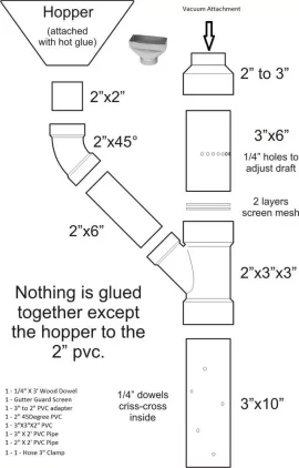

Here is the thread on the pellet vac with plans
https://www.hearth.com/talk/threads/i-made-my-own-pellet-vac-for-less-than-20-00-video.21107/
Reactions: Shane1
I Just built one of those pellets vacuums as I found a few bags that must have gotten damaged at dealer by moisture. the bagged had mixed pellets, sawdust and huge pellet/sawdust clumps. It was easy to put together but had to get a decent HP shop vac and tweak it to suck sawdust only and not pellets. Important thing is not to steal kitchen items as the funnel...found that out the hard way. (Inputs wife's slap)
Reactions: Shane1
[Hearth.com] ??? How to clean pellets This should be the design that I modified with the duct work hopper.
https://www.hearth.com/talk/attachments/pelletvacdiagram1-jpg.112553/
made one a couple weeks ago and it works great, no more dust every time filling the stove I usually pour slowly with a full bag then at about a 1/4 bag I stop and start a new one then filter out when I get a couple bags, works great as some bags have a lot and it keeps the wife happy also. I used a couple pieces of cheap plastic gutter guard to keep pellets from being sucked up, just turn off the vac so the pellet pcs fall in the bucket and not the floor.lol
Reactions: Shane1
think im gonna make one! looks good well done! what size screen did you use for it and i see theres two layers? thanks for the great idea
Cheap plastic gutter screen. Easy to cut and if you screw it up, you have quite a few more try's before you run out.

I know my sons cheap bbs stove doesn't like a lot of fines like most top load stoves, my Harman's don't care and will burn just about anything I've thrown at it, I use the vac mostly for the insert in the living room as to keep the saw dust down and because its harder to clean out the fines box, the p61 down stairs is a little easier to clean and fill so I'm not as concerned with the fines, as far as small pits and pieces go they'll load and burn no prob, I use the above design and adjust the draft so as to let all the smallest bits pass and just suck up the saw dust,,,
