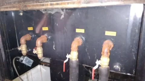

Ok guys, this is my first post. I need some help. Recently purchased this house which has a Empyre 250 from 02. It is absolutely on its last legs. It is a fairly open concept 1250sq ft house with a forced air electric system as well. I don't have the money to replace it and I am going to try heating it primarily with a wood stove next year. So my question is. Where do I begin to permanently remove a system I don't know to much about? I'm not sure where to drain the water from, do I disconnect from the pump and drain it there? Can I simply just remove the heat exchanger and seal the hole? Is there anything I should know about removing a side arm heat exchanger on the hot water tank? Thank you in advance.

Post some pictures , there has to be a drain on the boiler .

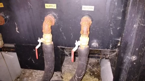

Would I be right if I said the black plug to the bottom right of the return line is the drain?

Sure looks that way, you could also adapt to the unused supply that is valved. You could use a fitting and short hose to get the bulk of the water out and away from the boiler. Then you could use the drain.
