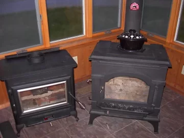

I bought a used Englander 13 stove off craigslist to replaced my VC. The problem I am having is the Englander has the flue exiting the top of the stove w/o a removable collar. I am able to remove the flue pipe on the VC by loosening the collar and sliding the pipe back and below the stove. How do I insert the last piece of pipe on the Englander w/o a removable collar?
Also, the Englander does not have any holes to hold the pipe to the stove. Does the pipe just sit in the fixed collar at the top of the stove?

Note: Depth of field is bad on the picture......it looks like the stove is against the wood but I can walk behind them.
You may need a slip section of pipe to get it on there. Might also need a stove adaptor for proper fit into the stove collar.
Ya just slide the pipe in the collar on the 13. Then drill three holes in the collar and pipe and put in stainless steel screws. ESW needs to start drilling those dang collars at the plant. I noticed at Lowe's the other day that the competition is doing it now.
A drill bit goes through it so fast that it makes you go "hmmm...".
