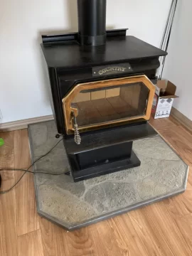

I have some questions about my 1997 Country Sticker wood stove with secondary burners. As you know I have tested several stoves with secondary burners before I sold them. This is my first experience in using one in my home. I understand that they allow more air in and cause a hotter fire with a beautiful flame but what do you people do to control the heat output on these stoves when the weather is not real cold?
When I have a good fire going, I can turn down the primary air as far off as it will go and the fire is still going at a very good rate. (This seems to only happens when I built a larger fire with hard wood) I have tested the door with both a lit match to see if air is being sucked in around the edges and with a piece of paper around the perimeter on the seal on the door and it is well sealed. My six-inch pipe from the top of the stove to the roof I would guess at about 18 ft.
I have good dry wood some mixed fruit trees with some pine. My stove seems to be sucking in too much primary air as it shoots the flame at quite a distance from the secondary tubes and sometimes, and at times only get orange and yellow flames.
If I build a smaller fire and try to shut it down then is smolders and the secondary's don’t work. Then I turn it up and I am back to a very warm home with open windows. Any suggestions?

As you close down the air, the draft will create a vacuum in the firebox and pull more air from the secondary tubes. This increases more complete combustion of the wood gases. Thus the flue temp will drop, but the stove top temp will go up. The solution is partial loads. Use less energy-dense wood species if you have them.

I like top down fires with 2 medium splits and lots of kindling. Secondaries light off fast but with a small fuel load we don’t over heat. The key is getting the heat to the top of the stove for a fast heat of the flue and good secondary combustion.

begreen, thanks for the reply. I have been trying smaller fires with milled pine ends but then we have feed the stove every two hours. I have two other stoves in my shop that I am thinking about trying but want to test them more before I do. But I am thinking that most stoves with secondary airs tubes are somewhat similar what is your experience? I did catch your closing comment "That's a Country Striker" is there something more you want to say if so bring it on. ;) I can always sell it and get a better wood stove.
WbS-P, thanks for the reminder on top down fires. I read begreens comments on how to use these wood stoves and have been using top down fires ever since with those nice fire starting cubes. I let the stove get nice and toasty or in my case blazzinginghot ha. But this stove seems to take in to much secondary air when I get a good draft going.
When my home is 60 degrees inside I don't need a real hot stove as we are well insulated. Are old farm house is 1300 square feet with two levels. I am sure we look odd to people driving by as they see our windows open. :eek:
I was reading on some comments on a YouTube video on secondary air VS catalytic that one person said the closed down there secondary air some and still have a good secondary burn with a longer fire. What are your thoughts?
