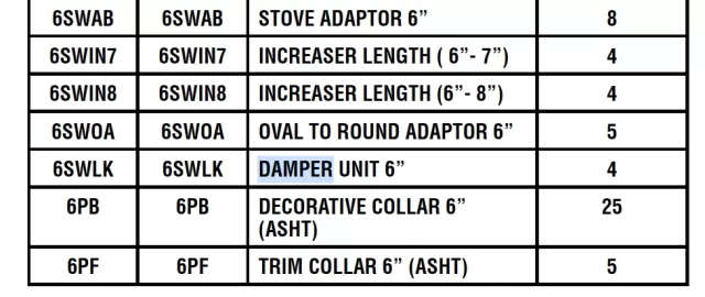

begreen, I was under the impression that a damper is not usually used with the wood stove with secondary burners?
Some manuals recommend it, some don't. IMO it's a good idea on any stove having issues with strong draft. With really tall chimneys it might take two. It's a common fix. In the Striker manual a damper is listed in the venting parts list.

begreen, thanks for taking the time to look this up and post it here. It is reassuring to know it is a common fix. I don't know why I have such a strong draft in 18 feet of pipe but when the stove pipe gets hot the stove it just goes crazy with the very dry pine wood. Other than that I enjoy watching the flame dance around and sometimes in mid air especially with the hard wood. Th e large window is great and stays fairly clean.

It happens in some locations due to local terrain and the chimney location. I think the pine is probably pretty high in oily resins which are contributing to its volatility. A damper should put you more in control.
