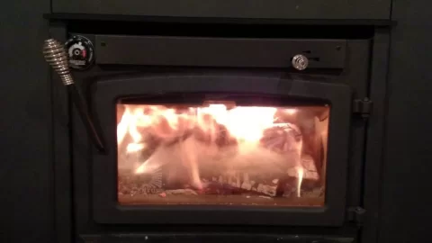

Thanks guys, now cruising at 475 with choke closed, really need to get an IR thermometer now to ensure not exceeding insert limit/overfiring
Where are you measuring the temperature?
Can you add your stove to the signature line in the account settings?
Century cw2500 will add to signature shortly. When the stove was warming up, I felt all around and the warmest spot was in the front next to the door. Just ordered IR thermometer to check operating temp.

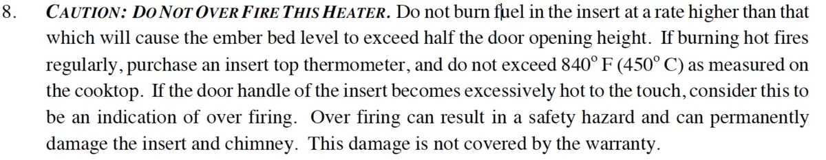

Century says to put the thermometer on the cooktop. They also say do not exceed 840ºF there.
Stove top. They use the term cooktop in the manual.

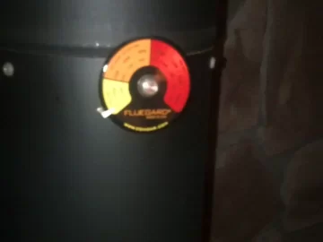

I use a Condar probe thermometer . When the probe reaches the upper range in the orange , I start to back down the air in 1/4 increments . I'll back down another 1/4 within 5 minutes , if temps are still climbing . I don't want to exceed 600F, so I'll cut own the air faster if the stove top temp gets up to 500F.
[Hearth.com] How to "cruise"?
I'm confused easily..... Your talking stove top max 600... Are you not gauging with that thermometer flue temperature.? Maybe they mean the same but I would like a bit of clarification from the crew. I'm thinking stove top is a thermometer on the top of the steel top and flue is what you have pictured. Maybe they gauge very close? But that's why I'm asking.
The OP has an insert so stove top readings are the best in this case. But that is just a guideline. Once you are used to the way the wood in the stove burns you will find yourself often using the fire itself as a guide with the thermometer reading as a verification.
On mine, I use a candy thermometer in the air gap. The temp reading there is relative, since it depends on blower speed, but it gives me a good idea of whats going on globally. Very difficult to get consistent readings on the insert I think. Temps are wildly different around the door/front of stove dependent on how the stove is loaded.@begreen, where did you find the recommended temp? I've never seen it in the manual...
Begreen thanks for confirming, previously either you or bholler mentioned 425 measuring on front door may actually be hotter inside. Second fire after when the temp was hovering around 100 I felt my way around the entire stove and next to the door was the hottest spot, I even check above the air gap where blower functions, it was cool to touch, but if the manual says measuring above stovetop don't exceed 899, I will prob operate around 400-500. Not gonna push it.
It says don't exceed 840F of the top I think. Our stove top has never been over 750F. Normal cruising temp is between 500-650F. You will be safe in that range and when temps drop down into the teens you will want the heat.

I'll experiment next time around with the IR gun. You'd have to keep the blower off long enough for the top to reach a steady state. Again though, where are you getting the recommended temps? Reread the manual, still don't see it in there...
Temperature is mentioned in the section warning about overfiring.
Yes, looks like they have rewritten some sections. Mine is an older copy.

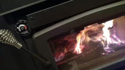

Well based on what I felt at a tolerable temperature, the stovetop is definitely cooler than front left panel next to the door, where I placed the gauge. Think I should be ok if I don't go above 600, I will confirm withe the IR tonight.
Cruising steady at 550 w seasoned oak and choke all the way closed . Nice secondary beautiful flame , thx, everyone!
