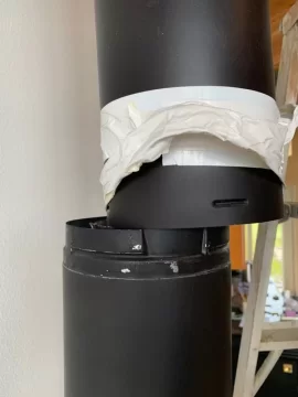

Update: I was finally able to separate those pieces. But with one major difference from Daksy's suggestion. You have to unscrew by rotating COUNTER clockwise when looking down the pipe. So, not to the left but to the right. I had a feeling that was the case which is why I asked for clarification. Here is a pic to show how the locking system works.
Note that I tried to wrap some belts around the pipe but I had to apply so much force to try and unlock them that they just kept sliding around. So I ended up wrapping white duct tape with two "handles" so I could apply more torque.
