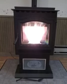

My feed rate is always set to 4, which Harman suggests is the default for a P68. The main thing feed rate is used for is to keep unburned pellets from being shoved into the ash pan down below. If you're not having that problem, then increase the feed rate.
This is what my P68 looks like on startup with a feed rate of 4. The stove is absolutely cranking, but it's not spilling out unused pellets. It gets hot in a hurry.
