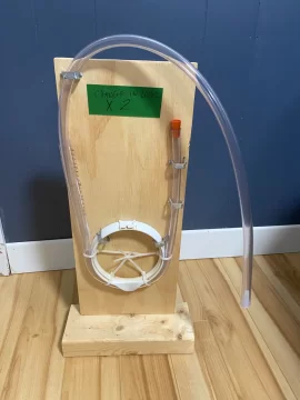

How do I do a vacuum check?
I was thinking that, but use Kroil. Kroil has never failed me and I live in the rust belt lol.
That check is on the install manual. You will need away to measure the vacuum which is under an inch water column. I made one out of tubing.
