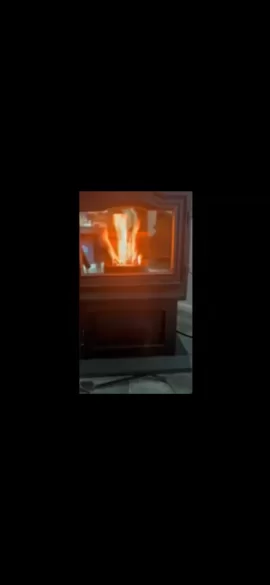

Thanks, appreciate it. Our flame has always been about 1 inch taller than yours. Now its all the way up to the top of the burn chamber.
Being tall is not what you want. You want it to dance and have a yellow flame that does not turn dark. Usually mine is not that big a flame. Most of the time maybe 4 inches high. Take a video of yours. Just make it short.
My wife took video of the flame with her Iphone 16 and sent it to me (android). The video greys out and does not allow me to select it to attach. Hmm
Thats a still image of the video.
No that it not good. The P43 burns pellets like a furnace. What you have is a campfire flame. Can you get OAK? Turn that POT up right away.
Yeah not good. Everything was peachy before so I am not sure what caused it. The wife did not adjust anything as I am the one who messes with it.

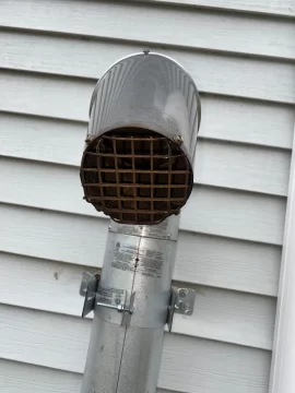

Morning. I wasn't able to fiddle around with it last night but did first thing this morning. The POT was fully turned clockwise so no adjustment could be made there. I went outside to inspect the chimney cap and this is where I am at fault. When I originally looked at it, I looked from the porch and could see the grate and through it, which is at an angle so I assumed it was fine. I took a flash light to it this morning and it was plugged up about 85% with ash. I did not see it from the angle I looked at it originally. My main mistake was misjudging the different type of chimney cap this one had compared to the one my Castle stove had. The castle had a wide mouth rectangular grated cap that bent down. The p43 cap that was supplied to us is just a bullet type cap with a 3" grate, a much smaller area. I did not take this into consideration with the cleaning schedule that it would plug up faster than the old exhaust cap we had and that is what happened. Despite the exhaust looking ok from inside the stove, it was a complete different story outside. One thing I also noticed was there were gobs of solid creosote on the tip of the exhaust cap. I am guessing this buildup is from the stove not running long/hot enough during it's room temp setting.
So this is pretty much my fault at not cleaning it enough. It needs done more than the Castle stove. Being as busy as I have been the past 6 weeks I could not find the time needed to service the stove.
The flame is now burning half of what it used to but I am running it full blast to burn off the creosote as suggested so I expect a higher than usual flame at this time.

That is very unusual on a pellet stove. It must have been burning really bad for a long time. Your original problem may still exist.
Current flame:
Great ! That looks really good. Here is a picture of my termination cap. Started burning in Feb and still burning. Never touched.
It is unusual but perhaps my settings were incorrect all this time. We will not be able to tell till next burning season as it's warming up now. My theory is what was mentioned here, that the fire wasn't burning long enough in room temp setting.
We had it on feed 4 at 75 degrees and temp probe rolled up and hanging behind the stove. It would get up to temp pretty quick and shut down, all day, everyday. Now I have the temp probe stretched out as far as it can go, feed setting on 2, and at 72 degrees. It is running much longer, in fact it has been running an hour straight and that has not how it has functioned since we got it.
I thought about the wood burner downstairs, how it has the ideal burn temp zone, and if you burn it in that zone then you have little to no creosote buildup in the chimney.
I will try feed setting 2 next season and perhaps everything will be nice and clean.
Reactions: Whitenuckler
