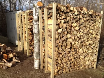

Even better than treated lumber now is the "fake" treated wood, the plastic stuff that looks like wood often used on docks and decks now. I have some scrap 2x6x8' planks of that which works great as a base for a stack. OR, do what I did and bury four treated 2x4x10' studs into the ground about 2' deep, then bolt (4" galvanized lag bolts) on cross members a few inches off the ground to make racks. My cross members are 8' long, the racks are 8' tall, and 18 to 20" wide (lenght of my splits), so it comes to about 0.75 cords per rack, and takes up very little space, yet dries the wood very nicely!

To each his own, but I'm not sure how "19 pallets" laid about your lawn is going to save any space! ;? Yikes! If your only stacking 5.5' high, then your going to almost double the required space that I use on my racks which are stacked 8'+ high. You can line up as many of them as you like, for as much storage as you like. They only require 24" wide each(18" splits plus 6" space between racks). I also add an exta foot between every other rack, so you can walk down the row to access them. I only have 4 of them, equalling 3 FULL cords (0.75 each X 4), and I keep 1 full cord in the shed in the background which I use to burn. I only have 4 because that is the only space I have, I have a VERY small yard. I have the rest of my wood (5 or 6 cords) stacked as rounds on the side of my house.

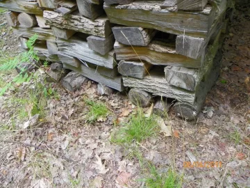

I am not a lover of pallets so we simply cut some saplings in the woods, lay those down and stack on top of them. This keeps the wood off the ground and the saplings cost us nothing. Occasionally we do have to replace some saplings when they start to rot but they last several years with no problems. Believe it or not, we also sometimes stack the wood directly on the ground. However, we live on yellow sand and there is no problems with water. But overall, it is a bit better to get the wood off the ground just for some additional air circulation.
The picture below shows a close up of one of the wood stacks so you can see the two saplings under the wood. btw, this particular picture is of a wood stack that was built in April 2009 and the wood pictured is still there. It will probably get burned next winter. Should be nice and dry, eh?

Looks like some nice Locust in there ready for next winter! ;)
Something I forgot to mention, ah, kinda a MAJOR thing for me! Pallets won't work in my yard because it's not flat. My yard is all sloped, so it would be difficult to make the pallets flat. Burrying 2x4's and bolting the cross memebers on lets me actualy utilize the extra space I get from the slope nicely. ;)
