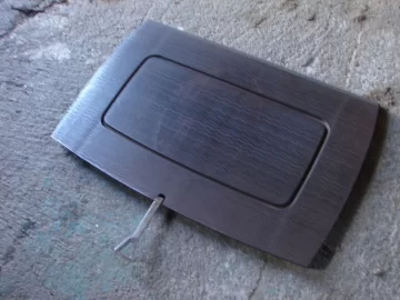

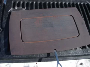

I had a similar issue. I ened up using a random orbital sander to clean it up. I was concerned that the sander would leave swirls and orbits behind, but I reasoned that anything would be an improvement. It came out fine. Not quite 'out of the box' condition, but much better. There is still a ghost image of the steamer, but you have to squint to see it. I sanded it back in September or October, and it has now taken on a rusty haze. As it happens, the stove is cold at the
moment. I think I will scuff it up again right now. Maybe even take before and afters. Hmmm....
By the way, the steamer isn't going to do much humditty wise. Mine was a gift from my in-laws, so I used it for a while. I stopped after the staining got bad, and a few refilling accidents ;). Got a small humidifier instead. Hate the noise of it though. I'd rather enjoy static shocks.
Ok, I went and did it. Here's before.........
[Hearth.com] How to maintain steel cooktop?
...And after:
The camera adds 20 lbs.... It didn't look as bad as the before photo, and it doesn't look as good as in the after one. Nevertheless, its an improvement. Posting this has already taken longer than it took to bring the top out to the garage, get the sander, do the deed, and put the top back on the stove. Upon closer inspection, it look like the rust has progressed a little. The stuff never sleeps, eh? There is some pitting around the ring of where the steamer was. I suppose I could undertake some more aggressive techniques, but there are, it must be said, bigger fish to fry. Oh well. Its just a piece of steel, after all. Just say no to steamers.
