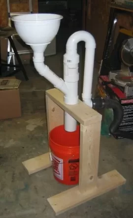

slvrblkk said:
......I've just been screening with a collander to get buy until I go to Lowes and pick up the pvc needed to make a pellet vac.
https://www.hearth.com/talk/threads/23999/.....
I made one of the pellet vacs, and yes, it does add another step to running the stove, BUT, I have never had an issue with fines clogging my stoves.....ever.
