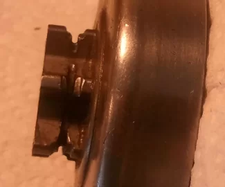

Best not this way....I got a Poulan 1800 Super off CL. Came with 2 chains. The chain wouldn't turn well - grabby. I look closer and sprocket is worn out. When the sprocket wore so much that the proper 52 DL chain could not be tightened...he put on a 50 DL chain.
Time for a new sprocket.

Wow! Hard to believe it worked at all. Assuming it's held captive on the crank by the clutch, you'll need a clutch removal tool and replacement spur sprocket/drum & bearing. You might want to get replacement washers- hard to check their condition with clutch in place. Some of the washers are dished and specific to that model saw.
Might be a good idea to see if you can get a combo drum&rim clutch. Can't hurt. Get a spare drive rim with it. Saves unnecessary drum changes.
