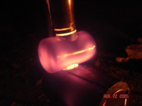

Two sure-fire ways to know you are over-firing your stove.
1) Thermometer
2) Stove is glowing red . . . or white
I suppose if you also wake up to find a molten mass of metal on your hearth that might also be a sign of over-firing as well. ;)
Best bet . . . stick with the thermometer.
I think its easy to figure out if you are currently over firing a srove (glowing/thermometer).
