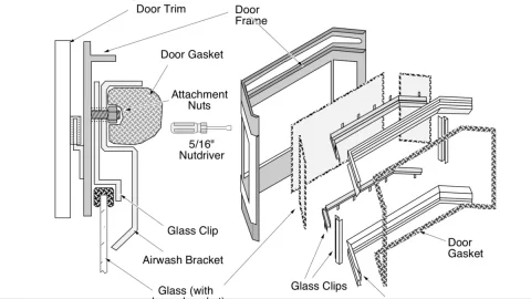

Hello
You must take off or blow out the air wash bracket on the inside of the door. If it gets plugged then the glass gets dirty much quicker!

Hello
Thanks! I am heading over there to clean it out and will try this today. Will let you know.
