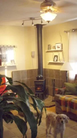

The placement situation is difficult. The clearances and protections necessary to insure your safety are likely to require more floorspace than you would want to give up. Our Morso sat on a raised (one foot) corner platform in a large livingroom. Even so, it always seemed to dominate the room. The platform is covered with ceramic floor tile and the walls (8' on each side) forming the corner are also tiled (different tile). The front of the platform juts out another 7 inches from the imaginary line that would complete the triangle. The stove was centered about 22 inches back from the front edge. I believe the Jotul site gives the clearances for their stoves in PDF form. It may be that the Jotul 602cb would suit your space and purposes better.

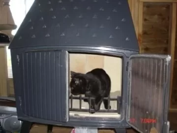

That's a very cute kitty--he likes the Morso, too.

and the correct observation from the photo would be, i didn't know that model had a cat burner!
