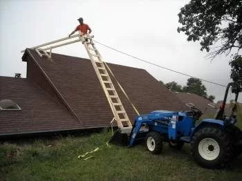

We went ahead and gave it a try. I think it's going to work OK and I can set it up and take it down by myself.
Looks like a mighty fine way to get hurt.
Call a professional. It'll be much cheaper than the hospital bills.
Besure to have your wife video every time to go up there. We want to see this train wreck....at least its not far to the ground once you clear the roof edge..
Clever rig, but I don't understand why you don't just lay your ladder on the roof & build a little platform with an inverted "V" bottom that will straddle the ridge. Simple, safe, not nearly so scary. Rick
I suspect the stove will be located neave the eves somewhere and not below the ridge. That would be the reason for the tall section of chimney above the penetration point. Presumeably his rig is built to allow him to get to the chimney cap once it is installed.
I would suggest using the contraption only once to install the chimney and using cables to stabilize the tall projecting portion instead of rigid stays. Then if you need to clean it, remove the telescopic stovepipe in the house (you were going to do that, right ?), lower the chimney into the house until the cap is just above the roof and you have a much safer configuration to clean. Now a regular ladder will allow access to clean and remove the chimney cap.

Yes, of course, you're right, Keith. Nevermind. Still, it seems like if the chimney extending above the roof is in sections, you could lay the ladder up there, fashion a little platform that locks onto the ladder rungs at the roof height of chimney penetration, go up and remove the top 4' or 6' section of chimney with the cap attached, bring it down & clean it separately, go up, clean the rest from up top if you want, reassemble. Either that, or a helicopter. Rick
Dude are you tring to kill your self theres got to be a better way then that.Try someting like roof jacks on the other side of the roof.set jacks and put down a plank and stand on that.
when there take pipe apart and clean pipe.
IF THIS DOESNT WORK call pro I would love to see more pictures of this rig you got going on so I can show the guys at work what your doing.PS take out life insuance. :bug:
Looks a little iffy to me too. For general work on my 12 by 12 roof which is 35' high I use a 48' extension ladder. I just installed a T6 and I just layed the ladder on the roof , braced the bottom of course and then installed the chimney. Mine is 11' above the roof exit to meet the 10' 2' rule. You just have to put the last pieces together and muscle it up and on. If its too harry then rent a couple of ladders and get a friend to help you.
