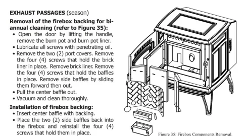

the air path from intake to chimney cap is restricted somewhere.. did you have these out and cleaned behind them?
