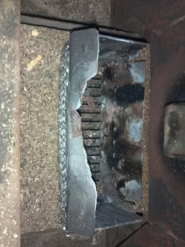

If you look at my burnpot you will see two things. First is the is no ash or clinkers in my pot after burning. I now get more than enoughbaur through there. I actually bought a OEM damper to make adjustments.
Second ...the front lip if the pot has been burned through. The cause was my lazy butt went too long between cleanings . And all the while a little ash drops through the bottom of the pot, building up and slightly altering the path of air through the pot causing it to lean just a hair, enought to eventually eat that part of the pot.
Air leaks, we no like them stinking air leaks, they mess up the air flow through the burn pile and cause all kinds of issues.
For example on the stoves having a burn pot with a u channel around the edge can find their burn pot buckling if there isn't a gasket in the u channel (under the lip) or if the burn pot isn't continuously welded to the rim from the effects of a burn pot air bypass. This is in addition to pile up in the burn pot.
Your combustion air should enter the stove, go through the burn pot and exit via the exhaust. No detours allowed. All detours will cause issues if not now very soon and some of these issues can result in fire where it shouldn't be.
Yeah, I should have added Smokey's remarks about the other air leaks. I sealed these as well.
