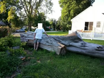

I read that beech makes good firewood and a friend of my neighbor lost a very large beech over the winter and cannot find any takers. I believe they have posted in on craigslist, etc but it looks like quite the bear. Any ideas on how to tackle something like this?

Looks like it might require about a 12 pack, couple of sharp chains, and an axe. Saw it into firewood lengths, if that's still too heavy to load on the truck/trailer, split em.
I've tackled oak and willow that large with a 16 inch saw. Cut into rounds, borrow or rent a log splitter that can be oriented vertically, and go to work.

All kidding aside it looks like an Oak I tackled a couple years ago. If you dont have a splitter once you get them bucked up just start from the outside and work your way around the log. Or better yet go rent/buy one as someone else mentioned
Wedge some supports under the log, back toward the base but leaving enough on the trunk end to counterbalance when you start sawing off the smallest rounds from the other end.

What's the diameter ? If under 40" a 20" bar will do, cut rounds , noodle or sledge n wedge , load up ,take home
Reactions: TreePointer
If you don't have, say, a Stihl 660 with a 36" bar (or longer!), then you can take your time with a smaller saw. Using a smaller saw on a giant tree can test the skill of even a seasoned sawyer. On the other hand, you can get good experience on that monster.
As mentioned, try to cut rounds at your firewood length. Have multiple plastic wedges handy and something like a splitting maul to hammer them in to keep the kerf from closing on your bar. On the larger end, you can buck as far as you can into the diameter as if you were starting a round, but then "noodle" out pieces of the round as you go. Definitely have multiple chains and/or sharpening kit to address chains when they get dull.
Having a second saw (or a second bar) can be handy if you tend to get bars stuck. However, a wedge or two should be able to get you out of most pinches.
Reactions: Jags and HDRock
Yeah that tree should provide a good "101" lesson in chainsaw operation. In order to avoid spending 1/2 your time freeing a pinched saw, you need to understand the tension and compression forces on the log. It's always best to start about 1/3 of the way on the compression side, and finish the cut from the tension side.
If the end you're cutting is completely suspended off of the ground, the tension will be at the top. As you complete the cut and the piece starts to fall away, the saw kerf will open from the top. If the end you're cutting is touching the ground, but the location you're cutting is not, the tension is on the bottom. The rest of the log will want to come to rest on the ground, so as you complete the cut , it wants to pinch at the top.
Also, if you decide to split by hand, or you can only gets your hands on a horizontal splitter, the chainsaw can be your best friend for splitting the big unsplittable rounds as well. If its too heavy to load, just cut that puppy in half.

You will need a big saw. The biggest challenge will be where the 2 crotches are. You will need a much bigger saw for that part.
I think it could be done with a smaller saw and some careful carving. Saw into the "V" of the crotch until you can make firewood size chunks from each branch. Like carving the drumsticks off a turkey haha.
