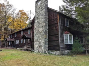

Huge stone fireplace 1920's house questions
LeahW

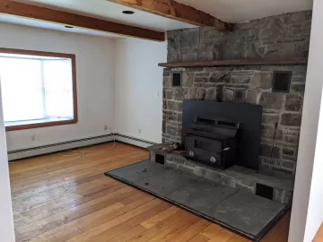

I just purchased this house and I need advice on who to call to advise me on what to do with this. I don't know if I should keep the stove insert or remove it. I want to make sure it's safe to use either way. The room upstairs directly above this has a fireplace too but without the stove insert. I don't understand this. I don't have any pics of the upstairs one but I will later in the week. Thanks in advance for any advice.

I can tell you chances are that insert is probably just slid into the firebox with no connection to the flue. If it was used much the chimney is probably a mess and there is a good chance there was atleast one fire in it cracking the liners. A new insert and liner will most likely be in your future. But get an inspection. If it is in the catskills the sweep market is much better than long island. Look at csia and the new york chimney sweep guild as well as local references.

Yes, I would also guess that this is a slammer. If the intent is to use an insert to heat, replace it with a modern stove. It will heat a lot better and you will get a nice fire view.

Nice place, looks like the house is a diamond in the rough, what ever you do, don't get rid of that stone chimney, its beautiful. Like what Bhollar stated, an inspection, chimney cleaning then an insulated liner is needed, depending on the inside diameter of the chimney flue will determine what type of liner you can fit, the insert to me looks like an older (1980's) fisher knock off, they are in-efficient stoves compared to today's tech.
Also since the house looks huge, you not married to just that location for a wood stove / insert, I dont know the layout of the rest of the place, but there's noting stopping you from installing a freestanding stove with its own class a metal chimney in another part of the house, the options are almost endless (no stoves in the bedrooms though) but that place looks like a nice spread, looks like you have some firewood standing behind the house to.

Looks like there are two or three flues in that chimney. Do you have a oil fired furnace or other appliances in the basement? Another option is to put a wood fired furnace or hydronic heater in the basement and then you can distribute the heat throughout the addition to the original house as well.
