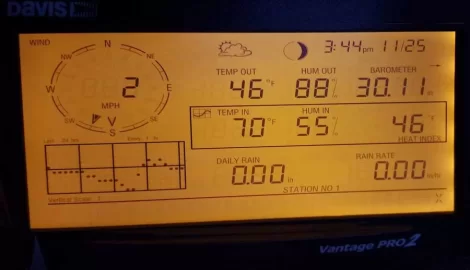

I just checked and coincidentally we're at 55% RH right now. 40-50% is pretty common for our house, especially with 85-95% outdoor relative humidity. No condensation. Below freezing we will see a little in the corners of the one small single pane window.
I have a Davis too. Love my Vantage Pro2. It replaced my Vantage Pro which ran faithfully for over 15 years
We've had it since about 2006?. The whole system just went back to the factory last summer for a rebuild and recalibration. It's working great.
Nice I will have to get on of those. What I meant to say is during the winter when the air is dry outside and the RH is lower keeping the inside of the house at 55%RH will most likely cause some condensation to form on the windows. I think 40-50% is ideal
Would you have a link or more information on your Davis system? Thanks
