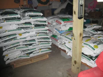

I have a basement[un-heated] that stays around 60 degrees all year...actually got below 50 during this years Vortex..
never had any problems.. I make sure to keep the pellets off the concrete floor and store them on pallets.
  • [Hearth.com] Humidity in Pellet Storage Area
