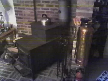

Does it look like the one in my avatar? If so, then it was made by Atlanta Stove Works. That is a plate steel stove with a cast iron door. I like mine and have used it for the last three seasons. Heats the place nicely.

Oops...sorry...just my dogs in the avatar.
See attached pic...
  • [Hearth.com] Huntsman stove
Reactions: Scott321968
Yes, it kinda looks like that but the secondary chamber on top is longer - within about six inches of the full lenght of the firebox. It has three round air controls on the front and the image of a deer jumping over a log cast into the iron.
Hmmm...must be a different model than mine. I would like to see a pic of that thing if you decide to buy it. I can still send you the manual (to mine) if you'd like. I don't imagine the stoves are that much different to operate.
