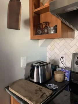

from the kitchen side, same unknown chimney option. here the cabinets are just placed around the chimney, nothing was done to that area when the cabinets were put in 8 years ago:

I think there is a second completely abandoned and roofed over interior chimney pictured in the second set of pictures, and it is not the same sound looking one from the first set of basement pictures, and we're discussing using the abandoned one for the stove?
I could be wrong.

No not at all. The chimney in question was taken down below the roof line then extended with what you see sticking out the roof. So the chimney needs a liner from the top of the masonry to the crock. Then class a from the masonry.

To clarify the pictures:
The basement pictures, and exterior shot, are of the main chimney in question with this post. The interior living room pictures with the exercise bike is the same chimney going through the living room. This chimney is the one that our people have looked at, and report they think it is a stable chimney. See the elevation drawing of the chimney layout with the first set of pictures.
My new thought was to bring the stove upstairs, because of the suggestions. I took the pictures of the living room to show the option of hooking the stove into the chimney in this discussion, near the exercise bike. But the cold air return is there, as seen in one of those pics. @begreen above, said that the cold air return needs to be a min of 10' away from the stove, by code, so that nixes that location.
The last set of pictures, posted out of order. The picture of the corner, with the 2 long black framed prints, is a second, mystery chimney, that I thought might be another contender to locate a living area stove. But we don't know the history of that chimney, probably from an old cook stove, before grandparents-in-laws had electricity. Mystery chimney is seen 1/2 exposed in the dinning room corner wall, and 1/2 exposed in the corner of the kitchen (above the toaster). Husband doesn't know where that chimney terminates in the attic. Regardless, it is out of the running, because it too is within the "10' no stove zone", due to the nearby cold air intake.
