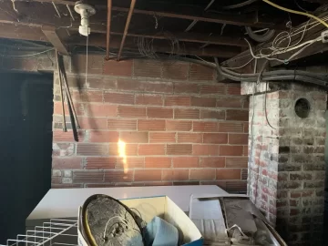

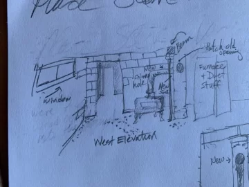

He rolled his eyes when I said "put a new hole for the stove pipe at the south side of the chimney, and abandon the open hole, and the covered hole." Is bricking up the open hole and leaving the steel capped hole as is a safe thing? I would think for safety that the bricked hole would need bricking too. But the liner should be air tight, so maybe it doesn't make any difference.

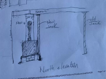

I like the idea of the jack to hold the beams for support. There is one jack in the basement at the beam already, about 10 feet away.

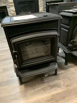

Plan is to get a 2cf stove now, like the Drolet Columbia. I don't know why I'm stuck on that brand, but it sounds like a sensible stove and made in Canada. Cost is a factor. I can buy it online from a link that Drolet has on their webpage.
We now have to get some estimates for the brickwork and liner. Also the jack for the support to supplement the brick brace that is there now. Thanks "Stinkpickle" for the thoughts for the south side chimney site and the jack idea.
