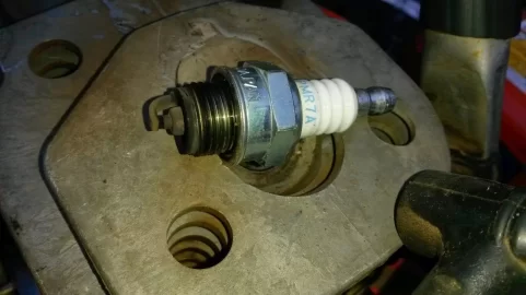

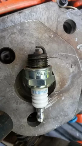

Today after cutting for 30 minutes I ran out of fuel. I refueled, added bar oil, and when I went to restart I got a no-start condition. Tried for about 5 minutes, than added choke, it would turn over, cough, then die. No choke, and it wouldn't even cough. I used another saw to finish up, and brought it home. Over an hour had passed and it still wouldn't start. I pulled the fuel filter, air filter, and plug. Do they look OK to you guys? I am not a small engine mechanic, but I am fairly mechanical if need be.

Sounds like fuel is sometimes not making it to the carburetor. I'd check the fuel line for leaks. Typically they crack in the little gap between the point where the hose exits the fuel tank and the point where it enters the air box / carburetor area. If you remove the air filter then you can pull a few inches of the fuel line up so you can get a good look at it. Stretch it out a little, bend it and roll it back and forth in your fingers while looking closely for cracks.
You should also carefully inspect the clamp where the intake attaches to the cylinder. The original clamp on most of these saws was plastic. It's a very common failure point, and when that plastic clamp breaks it creates an air leak which makes the saw run lean, which makes it run too hot and can easily destroy the piston and cylinder. I would check that out carefully before running the saw any more at all, because the updated replacement intake (now with a metal clamp) is a fraction of the price of a new top end.
