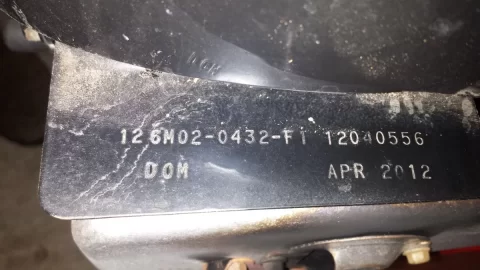

It should go carb--gasket--intake. If gasket is bad, you have an air leak. Posting engine model # can bring more accurate answers. Eg: 123K02 0193 E1
You need the 6-4-2 engine model # I showed above. Usually embossed on a sheet metal shroud.
This?
