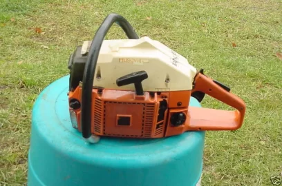

hey guys. i just picked up a used husky 61 rancher for 120$ . its the year with the metal crankcase.
the owner is shipping it from wisconsin, so ill get it next week.
he said the compression is 140lbs with a 16" bar. the bar is in good shape . it has a new gas filter, spark plug and was just tuned. he said it starts in a couple of pulls. if theres something wrong with it i can get rid of it within a week .
good deal???
1. i know 150lbs is the going rate for compression. is 140 ok?
2. i definitely know this is an oldie but goodie. what year you think it is? what other saw models have interchangeable parts?
3. anything i need to know? for example, i heard newer style bars and chains are thinner and not made like this one. so if i need a new chain i should get the bar as well. any other querks?
thanks guys. this should beat out my craftsman with a wiggly bar because of a broken bar lock bolt!

Was it a good buy? You'll know it when you get it. If it runs and oils and cuts, then I'd say that it was a good deal. If it needs a piston and cylinder...
As for the compression, it's hard to say unless it was YOU doing the testing with YOUR gauge. Some folks use the wrong type of tester, or don't test right...
well he said hes a mechanic at a small engine shop and he works on chain saws every day. he gave it a once over and replaced some parts. gas filter,gas hose,new spark plug and cleaned air filter.he said he will check idle and high speed with tack. And make sure everything is working before it is shipped .
anyone know the answers to the above 3 questions ? thanks. want to make sure i know everything about this saw.

Heres a better question to ask. Where is the chain break? You dont want to run a saw without it. Kick backs are a killer.
N of 60....Saftey 1st. :)
they probably didnt make em on this old of a year (circa late '80s?) . i think ill be ok. just have to beef up on my facemask and helmet.
can i add a brake?
heres a link for the part for sale.
http://www.jackssmallengines.com/husqp61.cfm
though i wouldnt pay 61$ for a brake to go on a 120$ saw. . . i can try to find one used.
Hey woodbutch Iam pretty sure it would of had a chain break as all my saws are early 80,s.
Anyhow if all the sellers statement are true, Id have that saw over a new piece of $200 Poulan junk anyday. My early saws have proved that. Cheers. N of 60

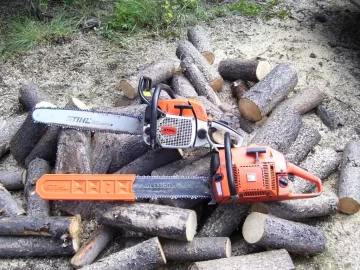

  • [Hearth.com] husky model 61 for 120 smackers? ? deal or no deal?!?!?

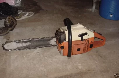

why would anyone remove it in the first place? cus they gum up?
I wouldn't want to use it without a chain-brake, but some old traditionalists didn't like them and would take them off, especially in the early days when it was a "new-fangled-notion" It does look from the first picture like there is a bracket just above the bar cover where a brake would go.
I would be especially nervous about not having a brake when I look at that old style "fat bar" - if you look at newer saws you will notice that the bars are much narrower - this is part of the anti-kick-back design of modern saws - by decreasing the bar radius at the tip, they decrease the "danger zone" area on the top quarter of the tip where kickbacks are most likely to be caused, and be most severe...
IMHO it might be a good saw engine-wise, but I'd want to find a brake for it before I actually took it into the woods.
If you are only using it for bucking felled logs, the brake is still highly desirable, but *slightly* less essential since you have less risk of catching the tip in the wrong position.
Gooserider
Also keep in mind that what brake it did have was very basic. There would be no inertial chain brake on this, which was a big advancement in kickback protection, and the brake was not meant be actively used as they are today. I wont run saws like this anymore.
well ive run em for 15yrs and had no problems. i dont understand. ive not had one instance where i felt the saw was gonna jump up and hit me. i think its cus i refuse to do undercuts on fell trees(which i sal i cut). i cut them with my 16" blade all on one side, then take a peavey and roll her to the other side and finish.
the only time i could see kickback happening is when you foolishly use the tip of the blade or undercut..
i know its there cus you never know, i got it.
but am i missing a scenario where it happens all the time?
please divulge so i can know to avoid these situations until i order the chain brake.

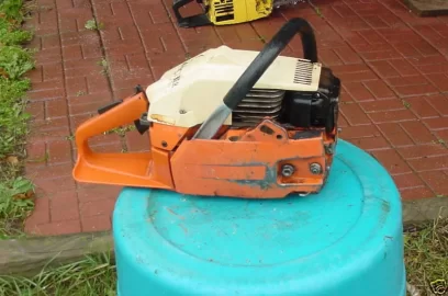

That saw looks just like a 262 or 266. I wouldn't be surprised if the chain break was the same. Go hit up a saw shop, one that been in business for years and I'll bet they have one kicking around. Or flea-bay.
Pop your cover off and take a look, but I think it should do.
