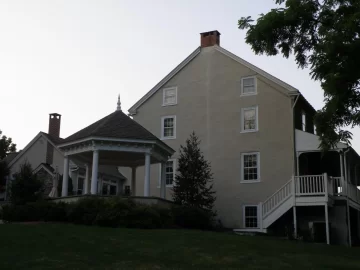

We have a boiler with 8 zones for heating the main part of our house, but our AC is broken into only three zones. One of these zones covers three floors in the oldest part of our house, with the thermostat on the middle level. This works quite well when it's hot enough outside that the AC is running frequently, but on days when it's less than maybe 85F outside, the system does not cycle frequently enough to keep the floors equalized. It's common for the middle floor (bedrooms) to be cool, while the upper floor is very hot, and the lower floor gets a little uncomfortable due to TV's, computers, etc. on that level.

Good info, guys. But problem is not our second floor as much as the... fourth. I was simplifying the problem in the OP.
Our lowest level is treated as basement, it's just a recreation room that we don't use too often. It's mostly above grade, actually walk-out on one side, but we call it the basement. Living space on second level, bedrooms on third and fourth. This fourth floor was finished maybe 10 years ago, so insulation is "modern", as far as can be done in 2x6 vaulted ceiling configuration. About 1/4 of the fourth floor is un-finished, and that's where the air handler resides.

We do have a ceiling fan on the fourth floor, but not directly over the staircase. This is an old central-hall four-square, with completely enclosed stairs on each floor, so that doesn't help with air movement.
