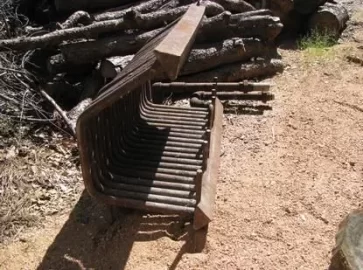

I have what I think is a hydro hearth insert in my fireplace. Its in line with my baseboard heat and works pretty good.I have to turn on the circulator whenever we start a fire. My question is it seems my boiler runs more when i start a fire and turn the circ on. I dont think im saving anything on oil by burning the wood but the house does get nice and warm. I' asked a few plumbers about this and they have never seen the hydro hearth and had no info for me. Any info would be appreciated...Thanks JgWalsh1886

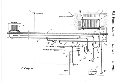

The one in the picture is what I have, the patent info looks like it too. Guess I'm wondering if I can save oil by shutting down burner while i burn wood. The circulator is the burner circ for my lower zone and not sure if it will run with burner off..Thanks webbie, as you can tell im not fluid in plumbing but frugal in plumbing (oil)
