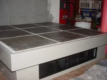

    When I put my fireplace in the livingroom I had to block up 9 feet of baseboard so I put a Hydronic Kickspace Heater in the raised hearth like the QUIET ONE KS2006 HYDRONIC KICK SPACE HEATER 7500 BTU. It works great!
    Here is a link to one on ebay but I got mine at HomeDepot.
    http://cgi.ebay.com/ws/eBayISAPI.dll?ViewItem&item=290471038248&rvr_id=137029500859&crlp=1_263602_263622&UA;=?*F?&GUID=b17b9b0d12a0a47a2eb78d77fff695c5&itemid=290471038248&ff4=263602_263622
    In the basement I put in an Electric Kickspace heater in the Wood pellet stove raised hearth as a backup. It will heat the room!!
    Good Luck
    See Black Grill in Hearth - Thermostat is on wall

    Thanks Don,
    I've seen these on a few sites. I think I need it to be off the ground. I do a lot of woodworking and the area I am planning to put it is prone to a wet floor in heavy rains. All the plumbing is up by the joists also. I will go to a few local supply houses and see what they have.
